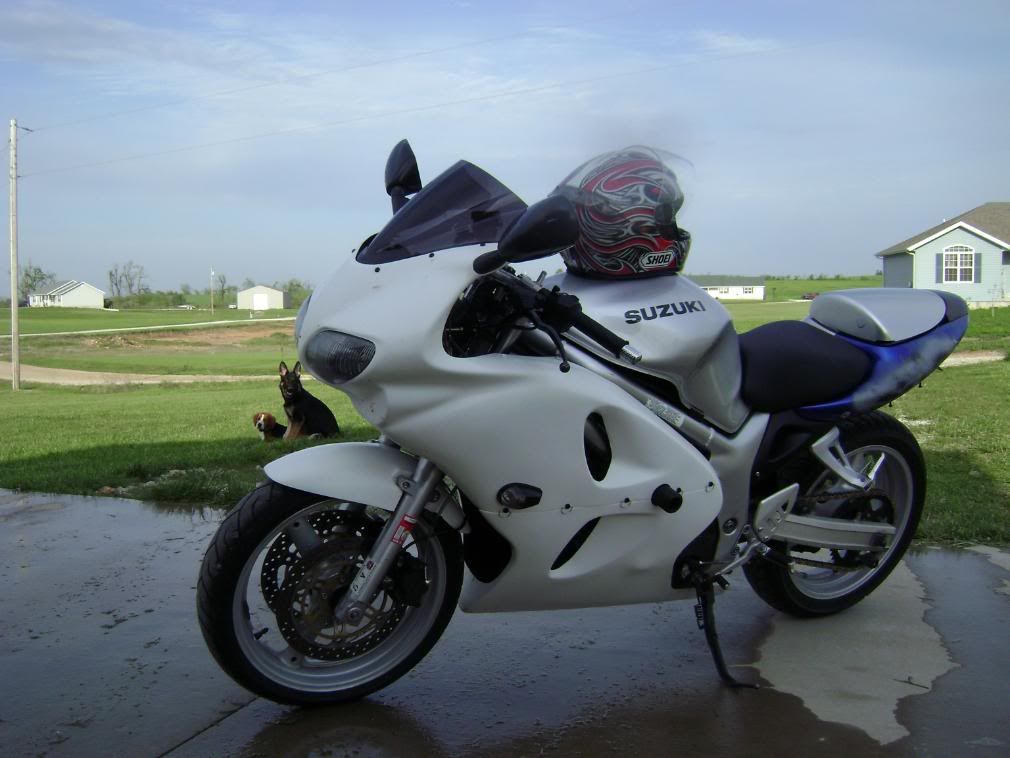

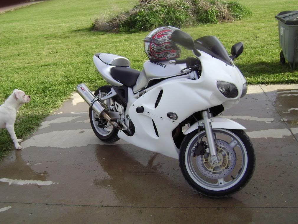

As I posted last year I pretty well totaled my SV on the 4th of July. I had the bike back up and running by late September, but it wasn't done. Just ridable. Here's what I had to work with after the accident.
After slowly getting the finishing touches taken care of I am now done except for paint, and thats where you guys come in. I would like some paint opinions from fellow riders :)
Not counting all the stock parts it took to get her back together, here is the list of mods she now has...
-KG Cycles fiberglass body kit
-HotBodies style undertail (I forgot the actual brand)
-Integrated LED blinkers in Euro taillight
-Flush mount front blinkers
-Puig windscreen
-636 rear shock
-Sonic Springs up front 20w oil
-Galfer braided SS lines front/rear
-EBC HH pads
-ART exhaust
-K&N air filter
-DynoJet jet kit
-RK gold chain 520 conversion
-Vortex sprokets (down one tooth in front)
-MotoSliders frame and swingarm
-Carbon fiber look brake/clutch levers
What color(s)????

Thanks :) The beagle (2.5 yrs old) and german shepherd (5 months) are mine. The american bulldog (6.5 months) is my roomates.
SO, he is what I've been thinking for color(s). Either a Ferrari/Ducati red like the red in my helmet. Gloss white, or white tail and front fender with blue fairings and tank...
I have 2 weeks to decide.... I think I'm gona cut holes where those flat spots under the headlights are too...
