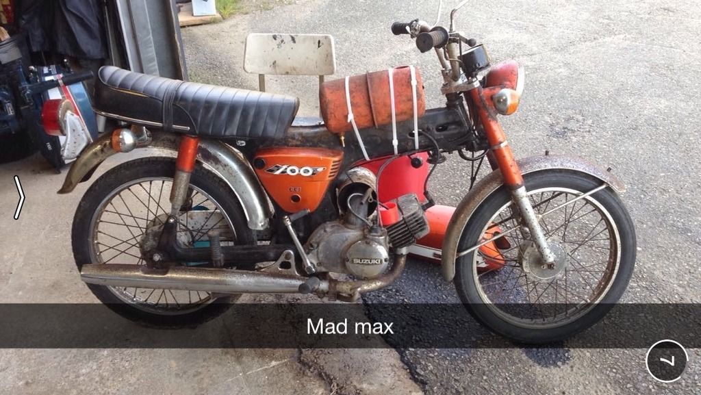

Hi,
new to forum and motorbikes. Just bought my first road bike, a 70's Suzuki A100. I think it's a 73 or 74. It's been off the road since '77 and is a bit rough in places. It has no papers or documents so I'm going to have to look into getting it back on the road. Plan just now is to get it running and registered.
From what I gather these bikes are relatively rare so hopefully I don't need too many parts. I'm used to working on cars and boats, I've recently finished restoring my '68 VW beetle, was a full body off resto which took 4 years.
Cheers,
Seumas

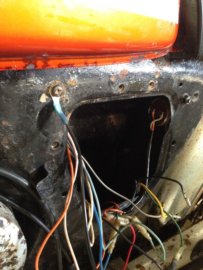

Having a look at the wiring today, it didn't come with a key so I'm wiring things to the battery for now to try and get it going. My budget is roughly £0 so hopefully it doesn't need too many parts.
Think I might just wire in a toggle switch as a battery isolator instead of the ignition switch.

Been having some trouble with the wiring. I've removed the ignition switch but I don't know which wires I should attach where. Right now I've put all the wires that were on the ignition (apart from the green one) straight to the positive on the battery and just put and earth from the battery to the frame.
The speedo lights are working, indicators, brake light, headlight all work but when all the wires are attached they're very dim.
When I attach the green wire to the +ve terminal nothing works.
anyone able to point me in the right direction?

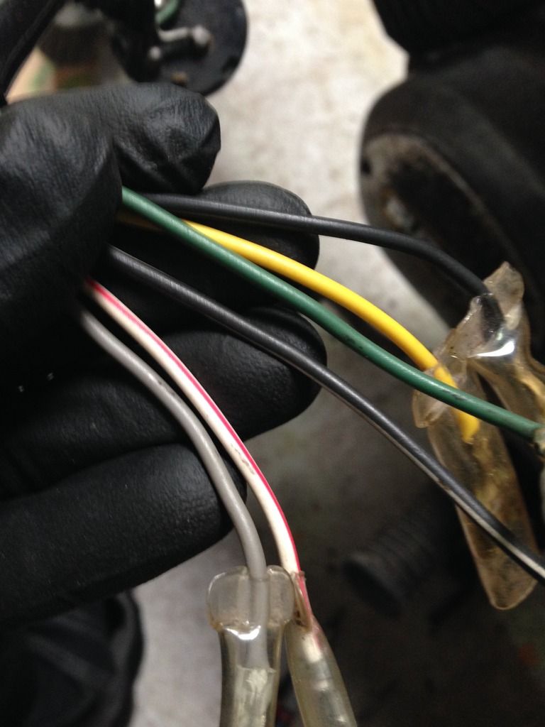

Had another look at it but couldn't match up the wires. Here's the wires from the ignition switch (now removed):
These wires all match up to wires from the harness. Two black wires connect to the solid black wire on the ignition. The black and white wire on the ignition was connected to the -ve battery terminal.
So far I think the orange wire is for the indicators and neutral light and the grey wire is for the headlight and brake light.
