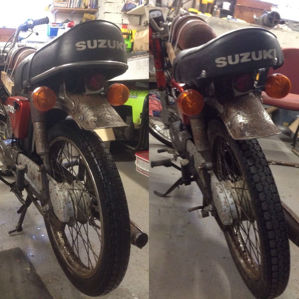

So today I got to the oil pump, had to take off the gear lever, side casing, chain, to get to it. Took it apart and it looked as new, drained all the old oil from it, made sure it wasn't seized and flushed it out with carb cleaner before bleeding the new oil through. I've re-installed the oil tank put fresh oil in it, fair bit of snow out today so no much testing, I've marked the oil level so I see if it drops. Still running premix in the meantime. Also fitted the new light, which I got for free. Made a bracket for it from an old alloy radar reflector mount. Not too pretty but it works!
Also cut a chunk from the rear mudguard, looks a wee bit less dorky now I think.
Before:
After:
Really rocking the rat look

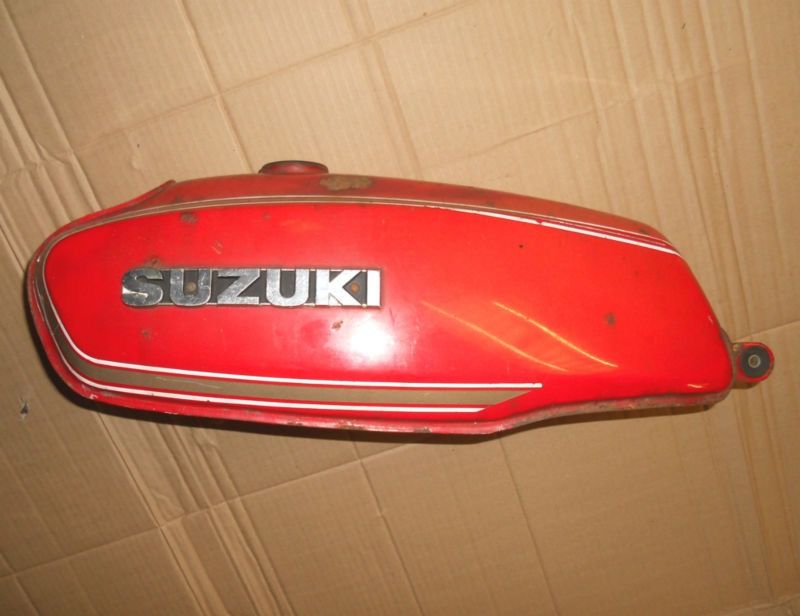

Ordered a new tank from eBay, £42.50, which brings the total so far to £194.35.
It's not identical, I think from a newer model but should fit.

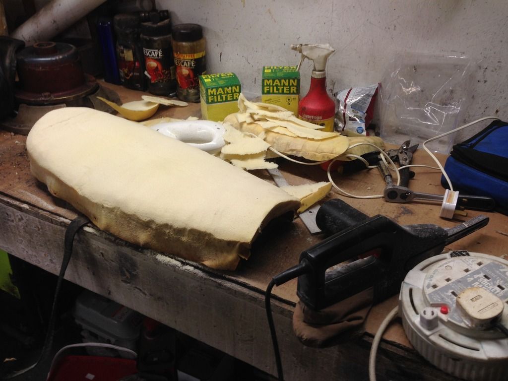

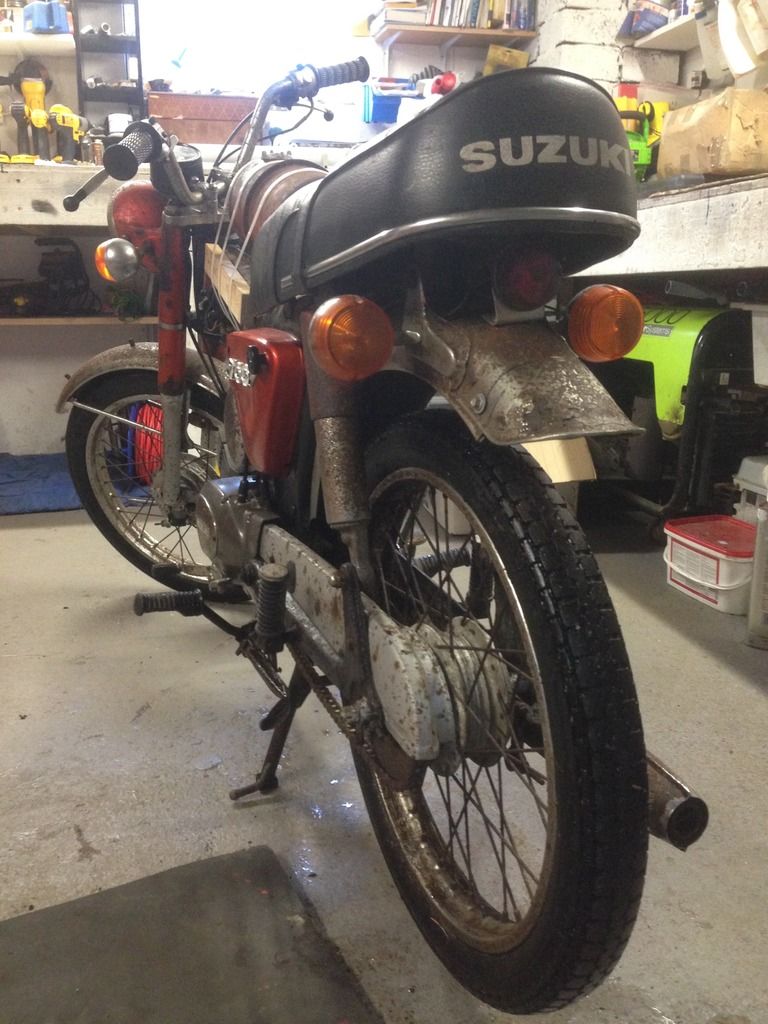

Spent this morning modifying the seat. Took it off and marked 20mm all the way around, the borrowed an electric carving knife and set to it. Looked a bit rough after this so then tidied it up using a powerfile.
Overall probably just over 20mm taken off all around. Put the cover back on and used to rivets to hold it in place.
Here's before and after:
Hard to picture how it will look with the tank in place but hopefully alright

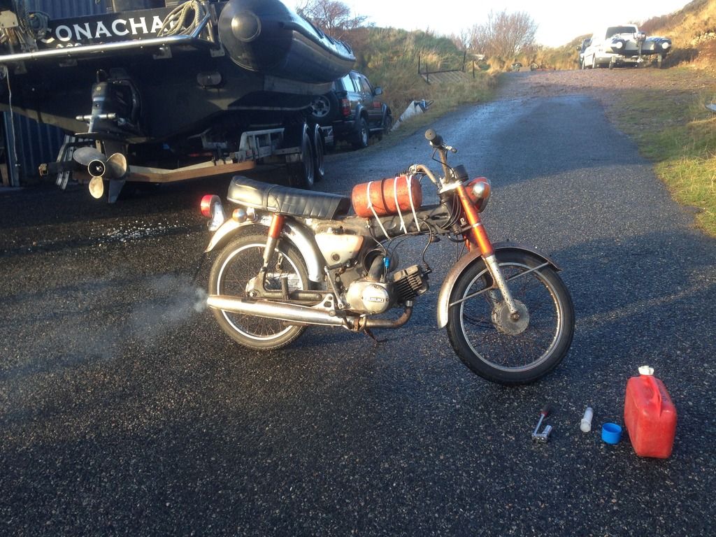

Had the bike out for a spin over the weekend, I've fitted an inline fuel filter and a new fuel tap. Bike started second kick after sitting for 5 months and first kick every time after that.
Thinking about changing the tires to slightly chunkier ones as most of the use is off road, anyone have any experience with this? There's not a lot of room for wider tread, even the thinnest offroad tires I've seen would be pretty close to hitting the frame. Was thinking a 100/100 would maybe fit on the back, and maybe even a push bike offroad tire on the front, 2.175" wide (standard is 2.50")
